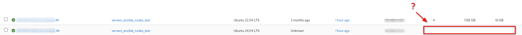

I have a strange problem in that I can only see data such as CPU, RAM, and HDD for 6 hosts in Foreman. However, a total of 17 hosts are registered in Foreman. The facts are missing for the remaining hosts.
Puppet Agent 7.34 is installed on the hosts with Ubuntu 22.04 LTS installed.
Puppet Agent 8.10 is installed on the hosts with Ubuntu 24.04 LTS installed.
All these hosts were registered in the same way. As you can see in the screenshot, it is independent of the Ubuntu or Puppet version:
All hosts are in the same organization and have also been assigned the same location. Also environment (= production). In addition, they have their own certificates that were successfully issued by the Puppet server (version: 8.7).

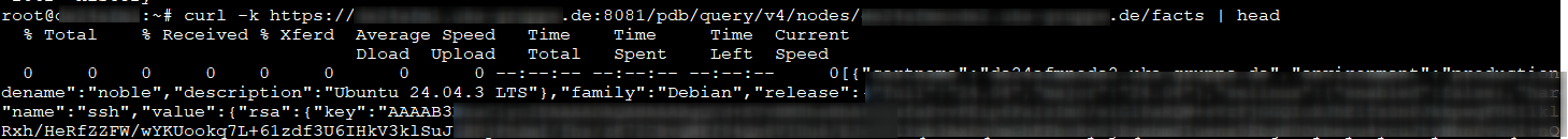

The server seems to have gotten the data it needs. I checked that with curl:
It looks good in the logs too:

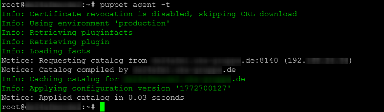

When I run “puppet agent -t” on a host, the result looks like this:
I don’t know what else to look for or what else to check.
