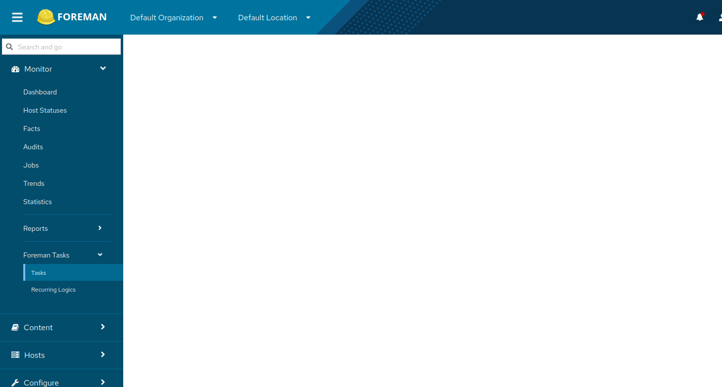

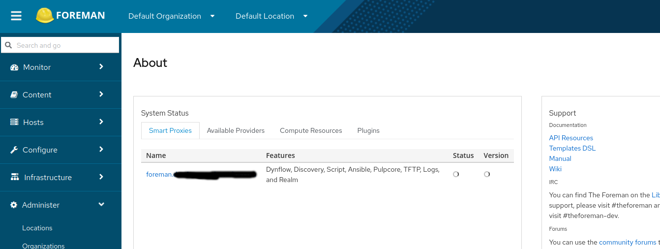

Problem: After upgrading to 3.11 the task page just shows up blank, even though it worked in the previous version. The source page also just shows blank
Expected outcome: all tasks shows on the page

Tasks page blank:
Smart Proxy Status:

Does the browser console say anything when you visit that page?
i get the below error in the browser console… I even tried to do a full reset as its a fairly small test environment but no luck
Uncaught (in promise) TypeError: o[e] is not a function
I was getting similar, I cleared all the data Firefox had stored for Foreman, and it started working correctly.
Thanks for the tip, i tried using a different browser instead and it was working. I will clear out the cache on my default browser later to resolve…
Had the same issue, didnt think of clearing browser data. Seems to have resolved it :slight_smile:
