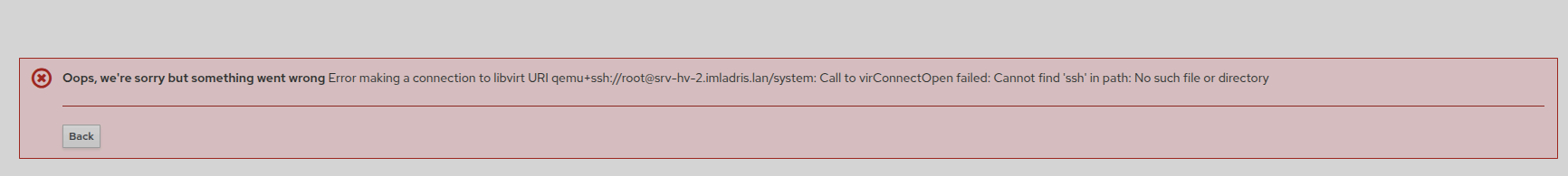

  2. It seems that the libvirt provider is looking for the ssh binary, and can’t find it:

The libvirt provider problem is much more important to me - the important metrics from foreman are the apache stats; but bundling libvirt and not the ssh client might be very perplexing for some.
