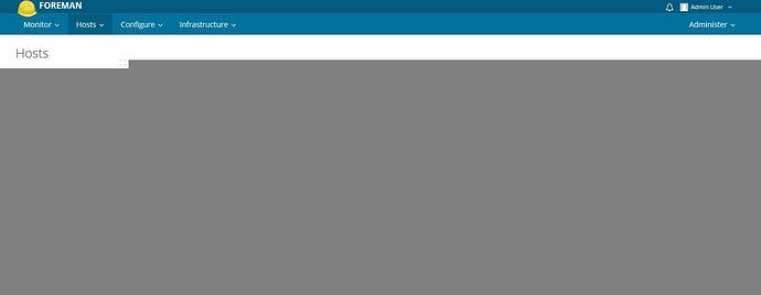

I have a problem with duplicate hosts in Foreman.
Info: My setup
Foreman = 1.15.2
Foreman_ansible = 1.4.5
ansible = 2.0.0.2
I use the callback plugin foreman_callback.py
as described here ->
Foreman :: Plugin Manuals.
I have configured my foreman and ansible.
Foreman-Settings:
Create new host when Facts are uploaded = Yes
Create new host when reports is uploaded = Yes
If i run on my ansible server:
ansible all -m setup
all is fine the hosts were created correctly in Foreman.
But if i run the ansible command again the host were duplicated.
Please see attachment how is look like.
Has anyone a idea why the foreman_callback.py duplicated the Hosts in
Foreman?
Regards
mobios
Sorry i forgot the attachment. Now i added.
I think this happens when you don't use the fqdn in ansible hosts file.
As soon as I started using the the correct fqdn I only got one host and no
duplicates.

> Hello Michael,
You are right. Thats was the clue
I changed my inventory file and all works fine.
  Thank you, Thank you, Thank you
