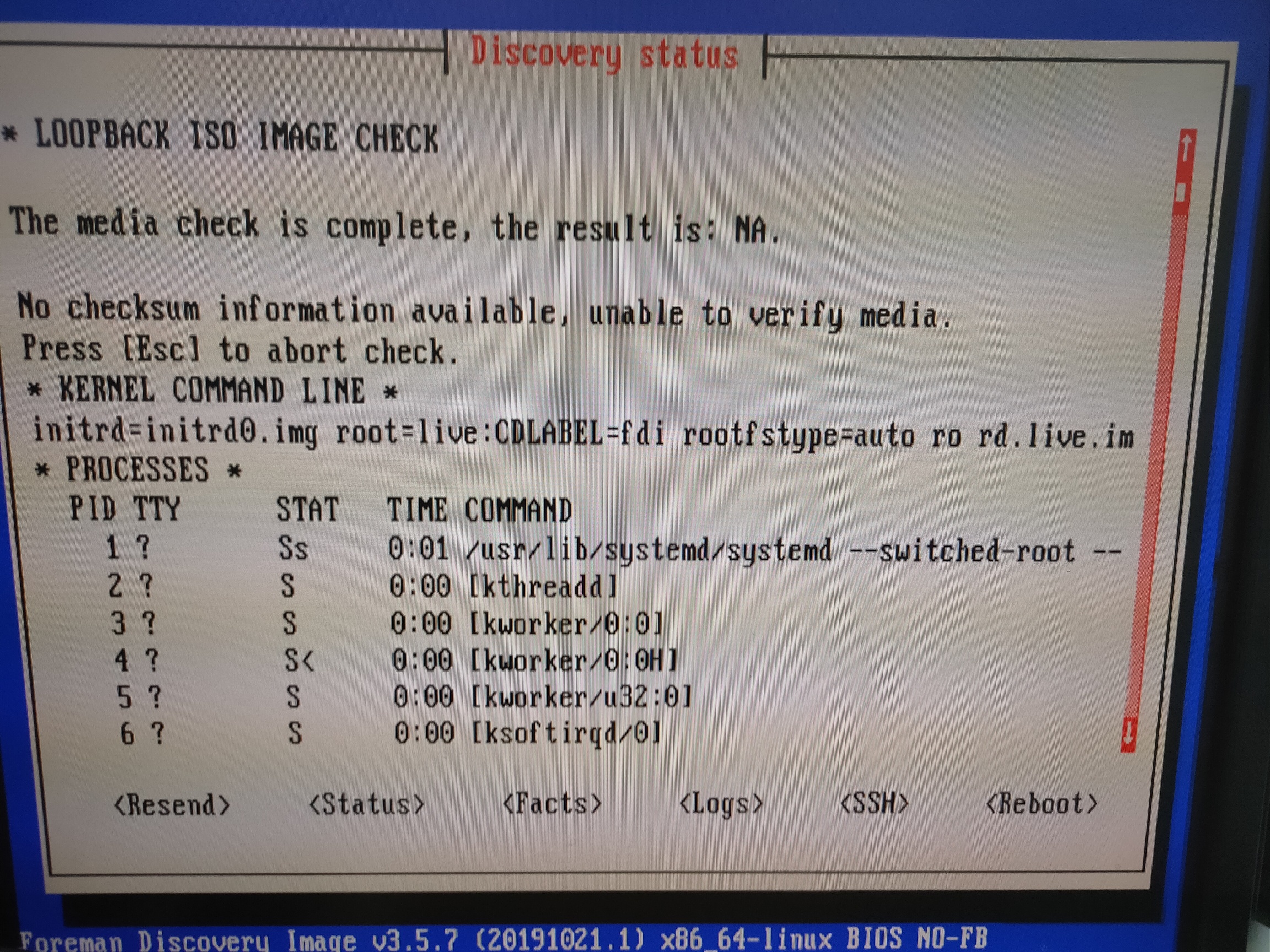

While attempting to boot the target node using the discovery image, it is throwing the error like “Unattended Installation Failed. Check Network Credentials”.
I have gone through some other links to find out what should be passed in facts while remastering the discovery image so as to get the target node be discovered by the foreman installer. Need your suggestion on this.

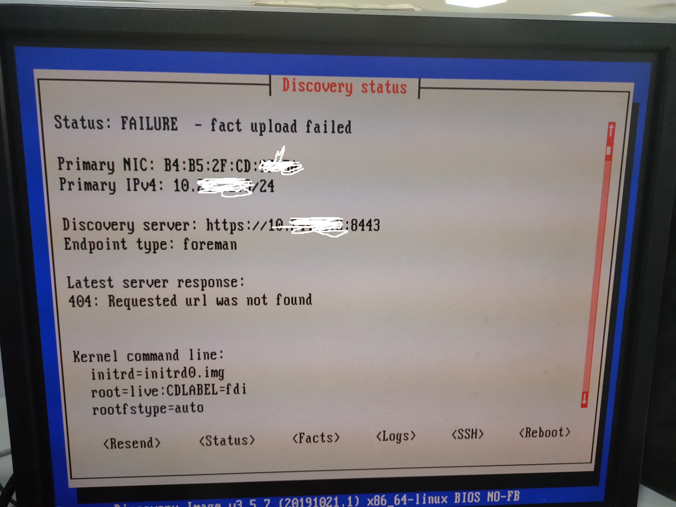

Please do not paste “errors like”. Paste them exactly the same, ideally attach a screenshot. I have never seen this error. At what stage do you get this?

As per the instructions, I have followed PXE-less discovery with unattended provisioning (fully automated) by using a fdi image booted on a usb device for making it discovered from foreman api.
Command used to remaster the fdi image:
./discovery-remaster /root/fdi.iso “fdi.pxip=10.x.x.x/24 fdi.pxgw= 10.x.x.x fdi.pxdns=10.x.x.x proxy.url=https://10.x.x.x:8443 proxy.type=foreman fdi.p xfactname1=security-token fdi.pxfactvalue1=4c204fd0-ad42-4ff5-9060-33e93600a616 fdi.pxmac=b4: b5:2f:cd:x:x”
Attached the error screenshot for your reference: Kindly have a look on it and help us on this please.
Hello, endpoint type must be set either to “foreman” if you want to connect to Foreman Server (port 443), or “proxy” if you want to connect to proxy on ports 8443 or 9090 if you use Katello. I know this is confusing, hopefully we change our ports to something more reasonable.

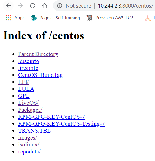

Installation Media: I mounted the centos7.4 iso in foreman server and copied it to a locally configured web location to access the OS files over http. I marked the same http path in Installation media also.
Templates mapped to the OS:
iPXE template
Discovery Kexec template
Provisioning template
PXELinux template
But I need a clarification on fetching the image. Is the image (in my case it is centos for installing on the target machine) can be hooked directly from the OS in which our installation media & templates are mapped together ? or do we need to edit anything from the template?
