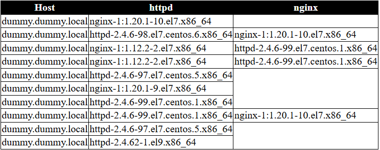

On Foreman/Katello 3.13/4.15 and when using the “Host - Installed packages” report in html format there is a couple of uses:
  1. All data in the tables comes unsorted Would be nice is it could sort in perhaps host?
  2. When more then one package is added to the search, packages are randomly placed in different columns. See attachment (replaced my real hostnames with dummy.dummmy.local).

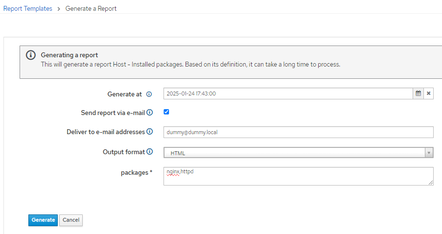

The way I generate the report is:
