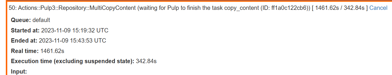

@jeremylenz I create a seperate content view and applied the below filters. When publishing a new version which includes the filters the task just sits there and doesn’t progress. Looking at the running steps it seems to attempt to poll some data. It’s not failing but attempting over and over again as I can see the counter going up every couple of seconds. Any idea what would cause that?

Looking at the dynflow console its sitting at step 50. I was able to publish a version without filters just fine but as soon as I add a filter its not getting past this step.
Hey @MajorNickle ,
Since I see MultiCopyContent there that means you’re using dependency solving – it dramatically slows down content view publishes. We have some warnings in the UI about it, but I would say to use it only if you really must.
Edit: also make sure that you’re using the latest Pulp packages, there was a bug fixed recently that might’ve caused slower than usual Pulp content copying.
@jeremylenz alright I think I got it working. Good old selinux was preventing /usr/bin/rpm from getattr access on /var/lib/rpm/Packages. After running restorecon -v '/var/lib/rpm/Packages' it’s now progressing.
