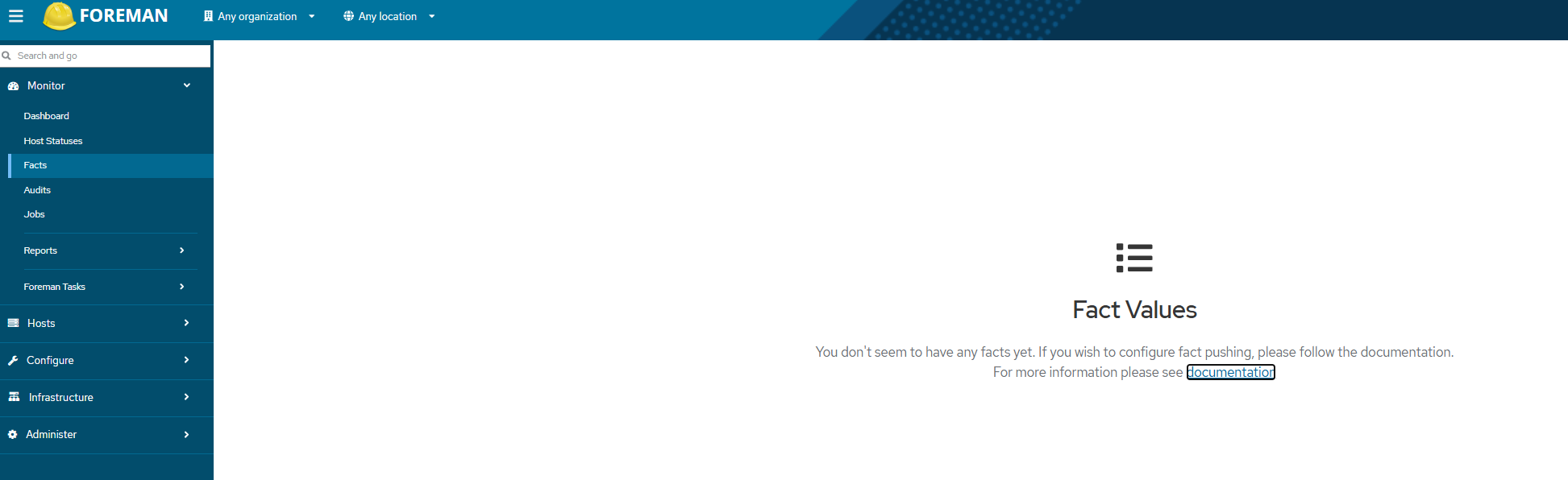

Currently I can’t see any facts from the clients managed by Foreman. The page is blank:
I followed these instructions to configure the collection of facts in Foreman as described here: Foreman :: Manual
And nevertheless I still have the issue that no facts are imported in Foreman.

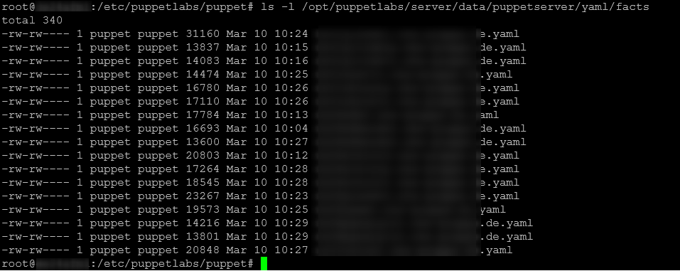

The host facts are available as yaml files:

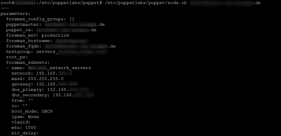

I could successfully retrieve the facts of a client on the Foreman server using the command “/etc/puppetlabs/puppet/node.rb node1.company.com”, as shown in the figure below:
It seems that the node.rb file is not the issue. It looks like this:

Does anyone know what the issue could be? Any help or hints are appreciated. Thank you in advance for your help.
This line looks weird, like the upload didn’t contain anything or the syntax was different. The facts upload mechanism seems to work though.
