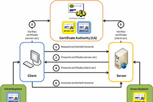

Any way, there is something I dont understand well about the kind of SSL Certificate verification that is taking place between Foreman Server => and Foreman Smart Proxy, and between Foreman Smart Proxy => Foreman Server . Could you please confirm me this verification is “Certificate based mutual authentication”?
Regards.
