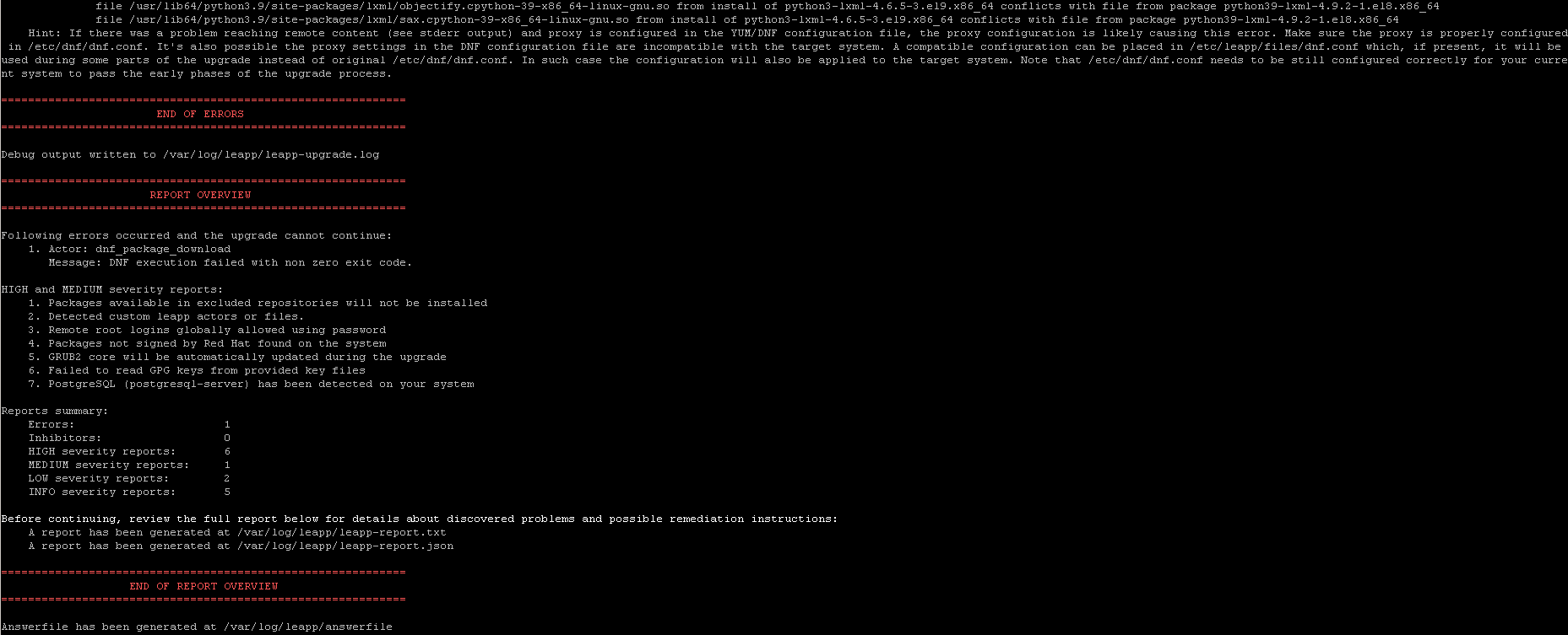

I am using Upgrading Foreman to 3.12 that instructions but get an error. The preupgrade is Ok but upgrade has then a problem by downloading.
ERROR:
Following errors occurred and the upgrade cannot continue:

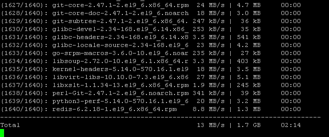

1. Actor: dnf_package_download
Message: DNF execution failed with non zero exit code.
He is downloading but gets that ERROR.

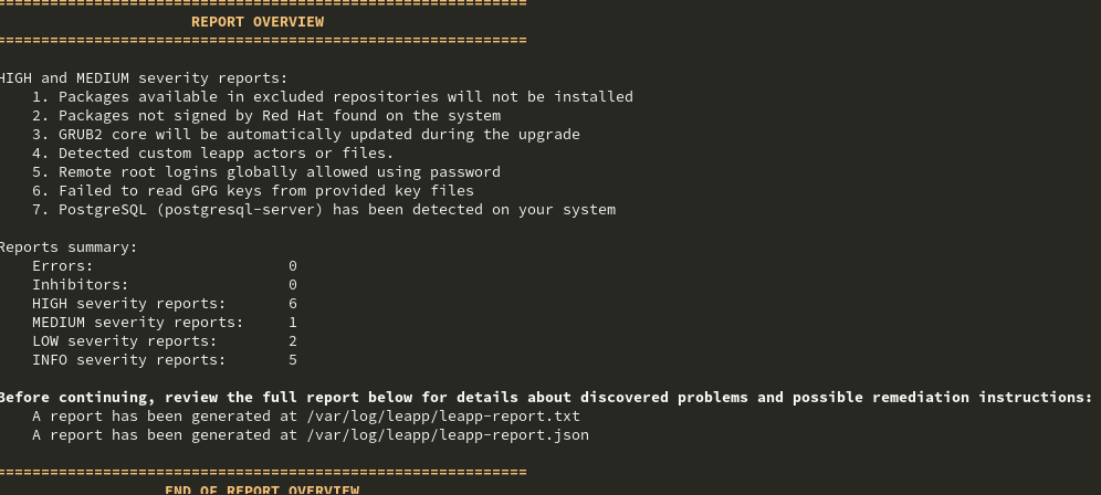

Preupgrade:
you can find the instructions on how to upgrade your Foreman and smart-proxy servers to RHEL9 here: Upgrading Foreman to 3.12

No i have problem on smart proxies by leapp preupgrade:
cat /var/log/leapp/leapp-report.txt
Risk Factor: high (error)
Title: DNF execution failed with non zero exit code.
Summary: {"STDOUT": "Red Hat Enterprise Linux 9 for x86_64 - AppStre  41 kB/s | 4.5 kB     00:00    \nRed Hat Enterprise Linux 9 for x86_64 - BaseOS   39 kB/s | 4.1 kB     00:00    \nPackage foreman-installer-1:3.12.1-1.el8.noarch is already installed.\nPackage foreman-installer-katello-1:3.12.1-1.el8.noarch is already installed.\nPackage foreman-proxy-3.12.1-1.el8.noarch is already installed.\nPackage postgresql-13.20-1.module+el8.10.0+22878+46d41b73.x86_64 is already installed.\nPackage postgresql-contrib-13.20-1.module+el8.10.0+22878+46d41b73.x86_64 is already installed.\nPackage postgresql-server-13.20-1.module+el8.10.0+22878+46d41b73.x86_64 is already installed.\nPackage python3.11-pulp-ansible-1:0.21.8-1.el8.noarch is already installed.\nPackage python3.11-pulp-container-2.20.3-1.el8.noarch is already installed.\nPackage python3.11-pulp-deb-3.2.1-1.el8.noarch is already installed.\nPackage python3.11-pulp-glue-0.29.2-2.el8.noarch is already installed.\nPackage python3.11-pulp-python-3.11.3-1.el8.noarch is already installed.\nPackage python3.11-pulp-rpm-3.26.1-1.el8.noarch is already installed.\nPackage python3.11-pulpcore-3.49.22-1.el8.noarch is already installed.\nPackage rubygem-foreman_maintain-1:1.7.6-1.el8.noarch is already installed.\nPackage rubygem-smart_proxy_container_gateway-3.1.0-1.fm3_12.el8.noarch is already installed.\nPackage rubygem-smart_proxy_pulp-3.3.0-1.fm3_10.el8.noarch is already installed.\n", "STDERR": "warning: Found bdb_ro Packages database while attempting sqlite backend: using bdb_ro backend.\nwarning: Found bdb_ro Packages database while attempting sqlite backend: using bdb_ro backend.\nWarning: Package marked by Leapp to upgrade not found in repositories metadata: gpg-pubkey leapp leapp-upgrade-el8toel9 python3-leapp\nTransaction check: \n\n Problem 1: package python3.11-pulp-rpm-3.26.1-1.el8.noarch from @System requires python3.11-createrepo_c >= 1.1.0, but none of the providers can be installed\n  - package python3.11-createrepo_c-1.1.3-1.el8.x86_64 from @System requires libdrpm.so.0()(64bit), but none of the providers can be installed\n  - conflicting requests\n Problem 2: package python3.11-pulpcore-3.49.22-1.el8.noarch from @System requires python3.11-cryptography >= 38.0.1, but none of the providers can be installed\n  - python3.11-cryptography-42.0.8-1.el8.x86_64 from @System  does not belong to a distupgrade repository\n  - conflicting requests\n Problem 3: package python3.11-pulpcore-3.49.22-1.el8.noarch from @System requires python3.11-pyparsing >= 3.1.0, but none of the providers can be installed\n  - package python3.11-pulp-ansible-1:0.21.8-1.el8.noarch from @System requires python3.11-pulpcore < 3.55, but none of the providers can be installed\n  - package python3.11-pulp-ansible-1:0.21.8-1.el8.noarch from @System requires python3.11-pulpcore >= 3.49.0, but none of the providers can be installed\n  - python3.11-pyparsing-3.1.1-4.el8.noarch from @System  does not belong to a distupgrade repository\n  - conflicting requests\n Problem 4: cannot install the best update candidate for package python3.11-cryptography-42.0.8-1.el8.x86_64\n  - cannot install both python3.11-cryptography-37.0.2-6.el9.x86_64 from rhel-9-for-x86_64-appstream-rpms and python3.11-cryptography-42.0.8-1.el8.x86_64 from @System\n  - package python3.11-pulpcore-3.49.22-1.el8.noarch from @System requires python3.11-cryptography >= 38.0.1, but none of the providers can be installed\n  - package python3.11-pulp-container-2.20.3-1.el8.noarch from @System requires python3.11-pulpcore < 3.55, but none of the providers can be installed\n  - package python3.11-pulp-container-2.20.3-1.el8.noarch from @System requires python3.11-pulpcore >= 3.49.0, but none of the providers can be installed\n  - conflicting requests\n Problem 5: cannot install the best update candidate for package python3.11-pyparsing-3.1.1-4.el8.noarch\n  - cannot install both python3.11-pyparsing-2.4.7-4.el9.noarch from leapp-foreman-plugins and python3.11-pyparsing-3.1.1-4.el8.noarch from @System\n  - package python3.11-pulpcore-3.49.22-1.el8.noarch from @System requires python3.11-pyparsing >= 3.1.0, but none of the providers can be installed\n  - package python3.11-pulp-deb-3.2.1-1.el8.noarch from @System requires python3.11-pulpcore < 3.55, but none of the providers can be installed\n  - package python3.11-pulp-deb-3.2.1-1.el8.noarch from @System requires python3.11-pulpcore >= 3.45.1, but none of the providers can be installed\n  - conflicting requests\n", "hint": "If there was a problem reaching remote content (see stderr output) and proxy is configured in the YUM/DNF configuration file, the proxy configuration is likely causing this error. Make sure the proxy is properly configured in /etc/dnf/dnf.conf. It's also possible the proxy settings in the DNF configuration file are incompatible with the target system. A compatible configuration can be placed in /etc/leapp/files/dnf.conf which, if present, it will be used during some parts of the upgrade instead of original /etc/dnf/dnf.conf. In such case the configuration will also be applied to the target system. Note that /etc/dnf/dnf.conf needs to be still configured correctly for your current system to pass the early phases of the upgrade process."}
Key: 1e26c8b86cec72c25c04ca045d2b0ed3e8ca2df5
Risk Factor: high (inhibitor)
Title: Detected unknown GPG keys for target system repositories
Summary: Some of the target repositories require GPG keys that are not installed in the current RPM DB or are not stored in the /etc/leapp/repos.d/system_upgrade/common/files/rpm-gpg/9 directory. Leapp is not able to guarantee validity of such gpg keys and manual review is required, so any spurious keys are not imported in the system during the in-place upgrade. The following additional gpg keys are required to be imported during the upgrade:
    - /var/lib/leapp/el9userspace/etc/pki/rpm-gpg/RPM-GPG-KEY-candlepin
Remediation: [hint] Check the path to the listed GPG keys is correct, the keys are valid and import them into the host RPM DB or store them inside the /etc/leapp/repos.d/system_upgrade/common/files/rpm-gpg/9 directory prior the upgrade. If you want to proceed the in-place upgrade without checking any RPM signatures, execute leapp with the `--nogpgcheck` option.
Key: e7e3f34a530e861b14f1cdd759cb62f92677066f
