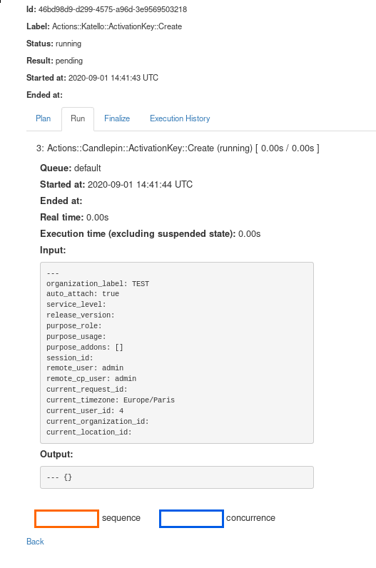

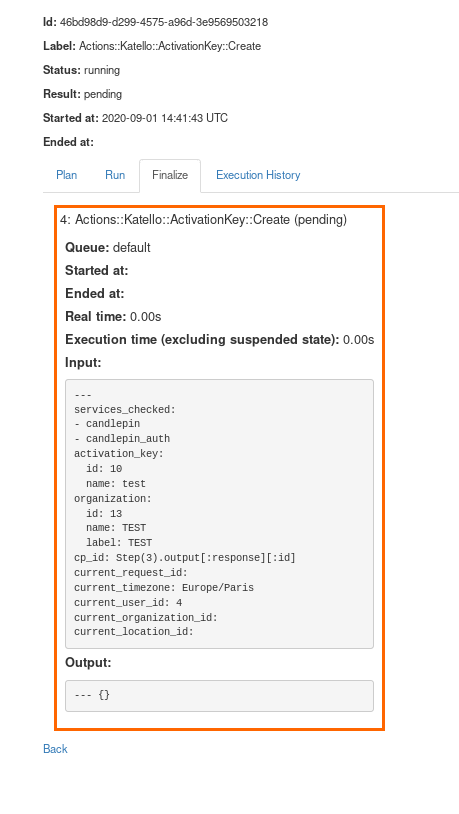

can you go to the task that created that activation key and click the dynflow console button and post a screenshot of what you see? I’m curious which step is taking so long
I tried the same on another foreman instance and activation keys are correctly created so I suspect an issue specific to this instance, I will redeploy it and retry with fresh install.
However, the 502 Bad Gateway errors with hammer are real (seen at host/smart-proxy creation/deletion).
Here is what I see:
But I think I’ve broken that instance by myself… I will retry on fresh install and let you know.
