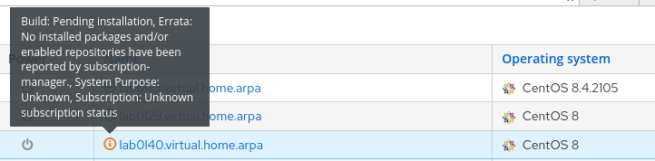

Here’s a picture of the issue:
After successfully kickstarting a new host, I tried to register it as a content host and found that the registration process changed the “Build:” status from “Installed” to “Pending Installation”

The build status changes from “Installed” to “Pending Installation”
Which should be fine, as long as it gets set back.
Well, unfortunately it doesn’t

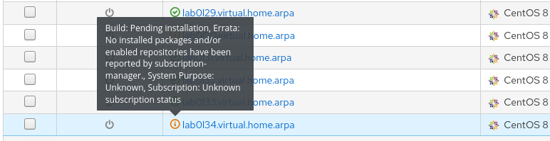

At the same time the build status was changed from installed to pending, the Subscription Status changed from “Fully Entitled” to “Unkown Subsctiption Status”

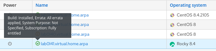

Interestingly Rocky 8 Content Hosts do not have their build status set to pending when this runs:
register_katello_host | bash
I did have to change a line in the global_registration.erb to get to a point where I could test rocky builds, but that aside it’s strange that the “pending installation” issue doesn’t manifest on rocky hosts.
The port 9090 issue didn’t disappear though, but since the build status wasn’t changed it doesn’t matter.
Furthermore the “Subscription:” remained at “Fully Entitled” so no issue there either.

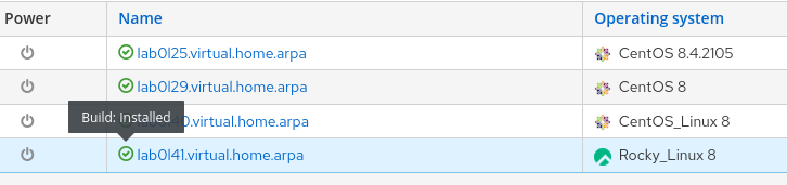

I can confirm that I am now able to curl port 9090 and set the build as installed using the default templates. Thank you.
/etc/foreman-proxy/settings.d/registration.yml, No change was needed it was as you described

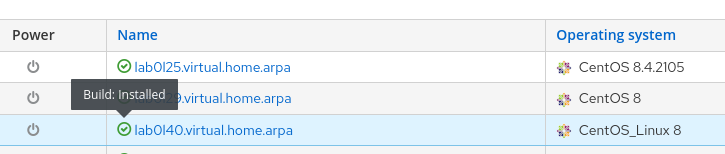

I will be running through the registration process manually, so that I can take Screenshots at the various stages of the registration, to hopefully properly demonstrate what I’m trying to describe.
First the CentOS 8 host:

This next command changes to the “Subscription:” state
[root@lab0l40 ~]# subscription-manager register  \
>         --org='Default_Organization' \
>         --activationkey=CentOS8 || exit 1
The system has been registered with ID: 7ea6a1b8-1abf-4027-9456-cc9162d7675b
The registered system name is: lab0l40.virtual.home.arpa
No products installed.
The next command will change the subscription state from “Fully Entitled” to “Unknown Subscription Status”
Again I will running the script by hand to capture changes.
register_katello_host > register_katello_host_script.sh
As you can see the Subscription state is now changed

[root@lab0l40 ~]# foreman_curl 'https://lab0l25.virtual.home.arpa:9090/unattended/built?token=ac017e1e-cbd3-460e-8bfb-7299b713608c'
This is the final state, you’ll notice the Build has been set to Installed, which is great however the subscription state is “Unknown”
CentOS_8-Registration_Completed
Ok, I’ll do Rocky 8 as well.
Freshly built
Registration
# Rendered with following template parameters:
# User: [admin]
# Organization: [Default Organization]
# Location: [Default Location]
# Operating system: [Rocky_Linux 8]
# Update packages: [false]
# Lifecycle environment id: [3]
# Activation keys: [Rocky8]
Running through the script manually

[root@lab0l41 ~]# foreman_curl() {
>   curl --silent --show-error --cacert $SSL_CA_CERT -o /dev/null --noproxy \* "$@"
[root@lab0l41 ~]#
[root@lab0l41 ~]# exit_and_cancel_build() {
>   echo 'Host [lab0l41.virtual.home.arpa] initial configuration failed'
>   foreman_curl --request POST 'https://lab0l25.virtual.home.arpa:9090/unattended/failed?token=ba991e4e-8bb2-49f4-883e-00c0c78a57cb' \
>        --data 'Host initial configuration failed, please see the registration log for more details.'
>   exit 1
[root@lab0l41 ~]#
[root@lab0l41 ~]# set +e
[root@lab0l41 ~]# trap 'exit_and_cancel_build' ERR
[root@lab0l41 ~]# echo "Refreshing subscription data"
[root@lab0l41 ~]# subscription-manager refresh
All local data refreshed
[root@lab0l41 ~]# trap - ERR
[root@lab0l41 ~]# foreman_curl 'https://lab0l25.virtual.home.arpa:9090/unattended/built?token=ba991e4e-8bb2-49f4-883e-00c0c78a57cb'
Obviously if it wasn’t doing a “-o /dev/null” we would have seen an error on that foreman_curl, because the build status is not pending.
And here is the final state
So it’s not doing the same thing that CentOS 8 is, something is defnitely buggy here. I hope this helps someone track down what might be going on.

If that works then I just need to figure out why Rocky 8 hosts don’t change from Build: Installed to Build: Pending Installation when register_katello_host runs the like CentOS 8 hosts do.
