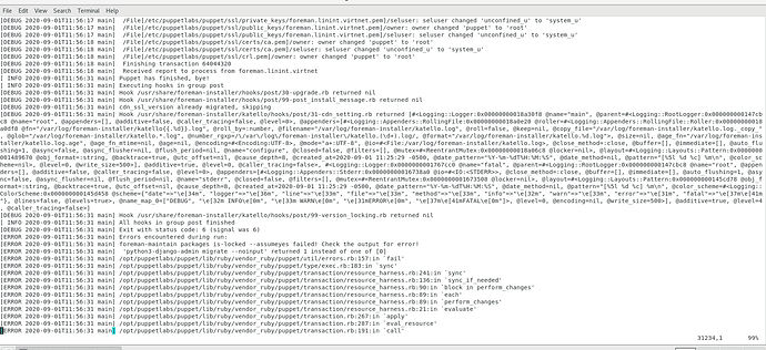

ah, do you have FIPs enabled? We don’t yet support running with fips and pulp3 unfortunately as pulp3 doesn’t yet support it, but it is on their roadmap. Are you able to run without fips?
It turns out setting FQDN in /etc/hosts doesn’t automatically fix the hostname. the hostname didn’t pick up the change in /etc/hosts so I used the “hostname” command to reset the initial hostname and then it picked up the FQDN from /etc/hosts. This was a fault of mine on this one. Always check “hostname -f” prior to running a FQDN sensitive command. Lesson learned.
As for the first issue. It was indeed due to FIPS as a non-FIPS version ran fine. Thank you so much for the quick turnaround.
If there is a command related to skipping checks, I don’t know what it is.
I believe this was just a goof on my part. I recall the official instructions saying the system needs a FQDN. I had set it in /etc/hosts but didnt check to see if it changed the hostname afterwards.
