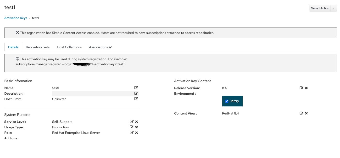

System is building with “synced content” option in host configuration.
Also i’ve added activation key.

Could you also share what you’ve picked for the host while provisioning? Or maybe take a look at the provisioning template preview for that host and see what it tries to do with subscription-manager. You can try to set the param subscription_manager to true, but given your answer, it should work already (as long as you set some activation key for that host)
I’ve set activation_key, subscription_manager and subscription_manager_org in host settings but after build, host is not registering and still baseurl in rhsm.conf is wrong, pointing to cdn.redhat.com not to my katello URL. Also i’m not seeing any option in redhat_register snippet for providing baseurl variable.

Ok, thanks, defering to someone more knowledgable in this area. Hopefully we have enough information for debugging.
I found solution for both my problems.
For 1. i had to set kt_activation_keys not activation_keys in host params.
For 2. i had to sync RedHat 8.4 repo not RedHat 8 repo.
