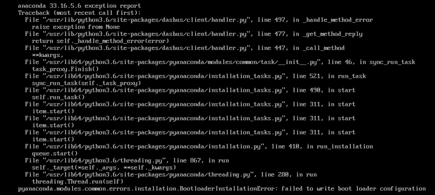

problem partially solved: using customized Kickstart oVirt-RHVH with parameter ‘liveimg_name’ I complete the installation but the error at the end is failed to write bootloader configuration
I suppose that the boot partition is too small.
Update: this is the error after install
Please ask the oVirt community and provide the full KS template preview. Looks like some bug in Anaconda or KS problem.
