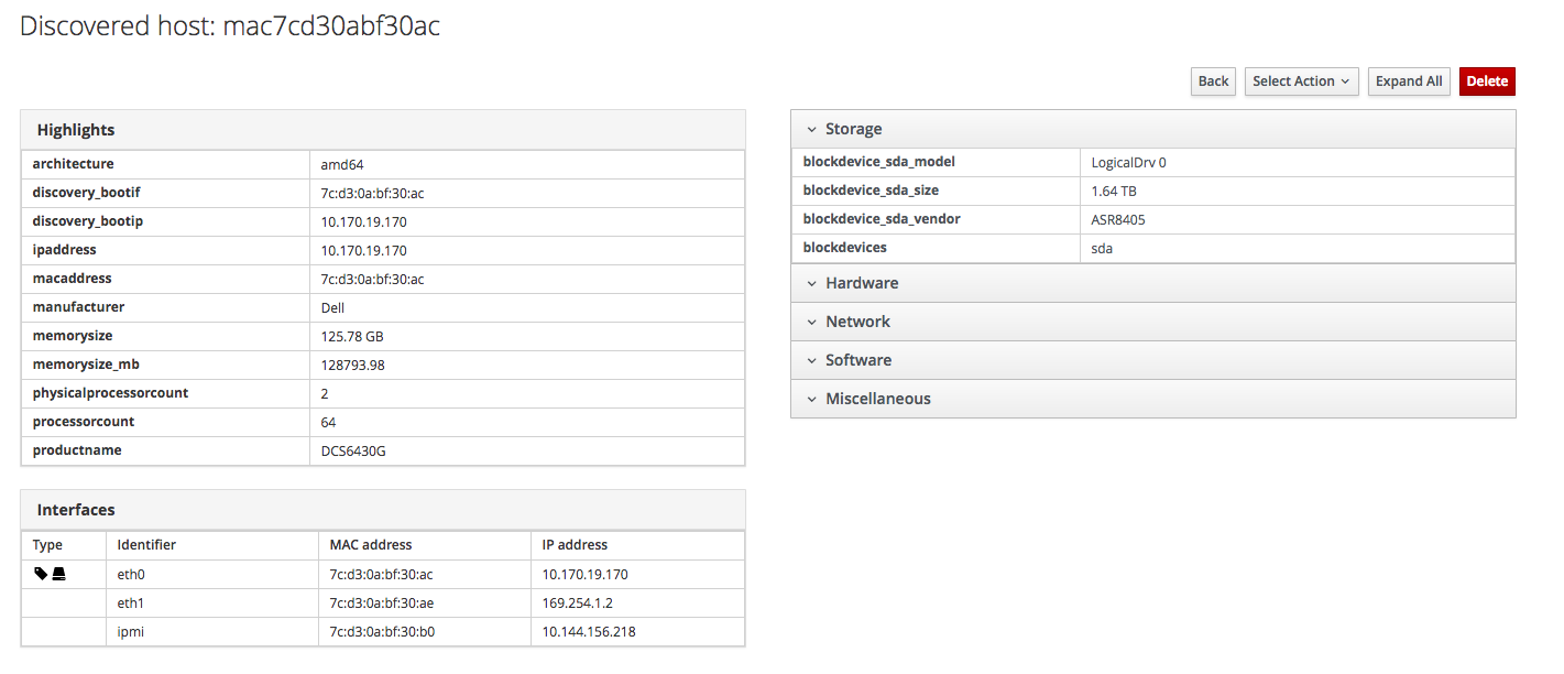

When delete such invalid duplicate hosts while keeping "semi-good" one and
restart discovery on a host side, things get back to normal. Even dashboard
view starts showing model now, but still no IP:
<https://lh3.googleusercontent.com/-XOIRJQ_XODQ/WLSthYiLTTI/AAAAAAAAADU/UuanXjdNLHsAO2nhoF2c3lWgmZv5Pij6ACLcB/s1600/Screen%2BShot%2B2017-02-27%2Bat%2B2.51.29%2BPM.png>
