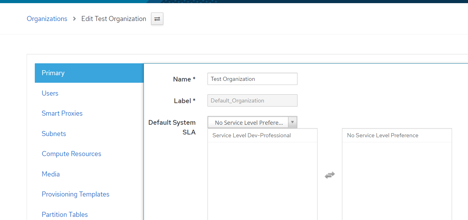

[root@localhost ~]# subscription-manager register --org="Test_Organization" --activationkey="rhel 8.3 activation key"
HTTP error (404 - Not Found): Couldn't find Organization 'Test_Organization'.
Is everything OK on your server? hammer ping

I just noticed in your screenshot that it appears that key belongs to Default_Organization - see the info notice toward the middle of the screen. Try with that org instead. If you intended the key to be in Test_Organization, create another one over there
I think I kept my default org as test organization. Where can I check that?
@Jonathon_Turel
[root@localhost ~]# subscription-manager register --org=“Default_Organization” --activationkey=“rhel 8.3 activation key”
