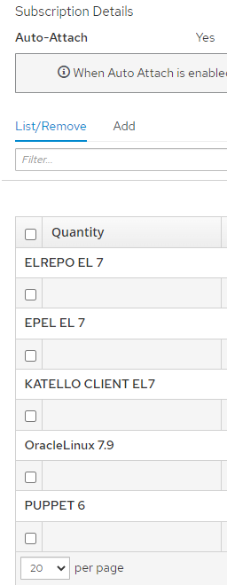

They are normally listed in Activation key:
But when i register a host they do not get the subscriptions…i can only add them manually.

Would you be able to show the subscriptions tab of the OracleLinux_7_9 activation key? Also, after registration, is there anything in /etc/pki/entitlement/ on the client?
