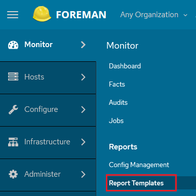

The report templates are in the main nav under Monitor > Reports > Report Templates.

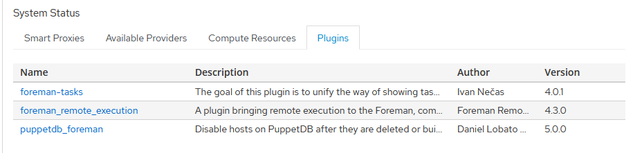

Here are the list of plugins used on this legacy Foreman instance:

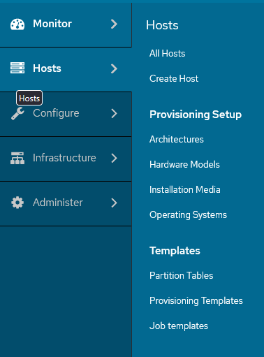

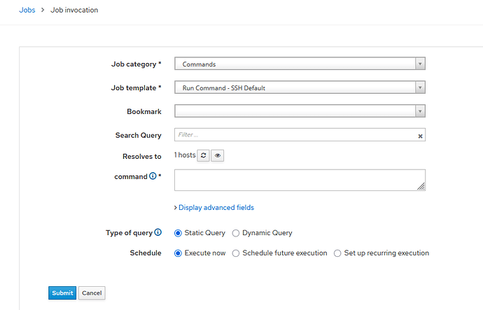

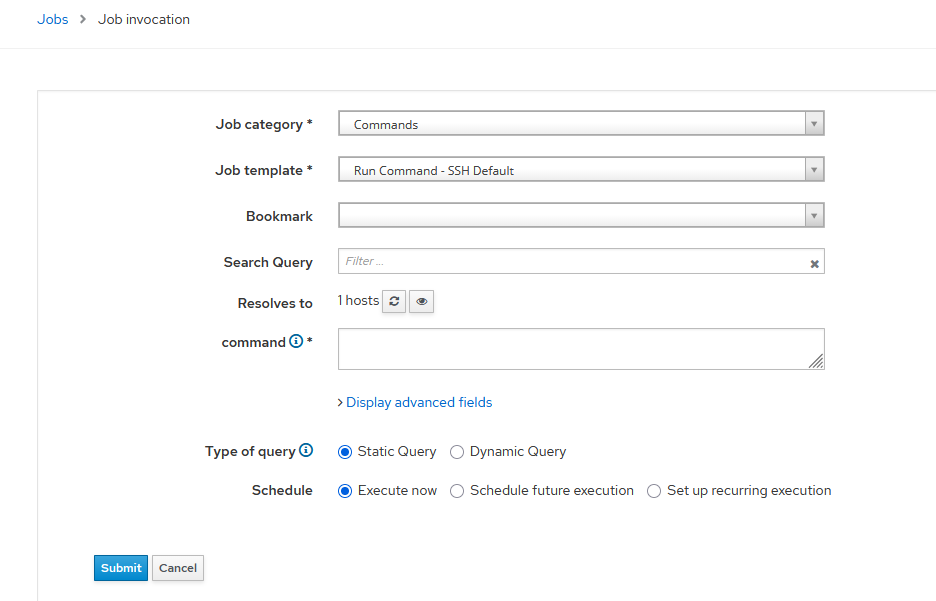

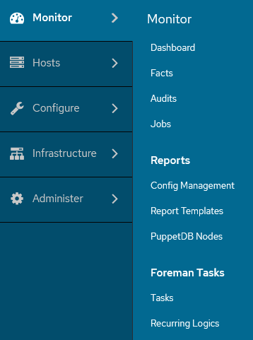

Additionally here are a few screenshots from the Foreman UI menus (Monitor / Hosts) and also the “Job invocation” page:
Monitor menu
Hosts menu
Job invocation page
Monitor > Reports > Report Templates > Job - Invocation Report

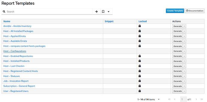

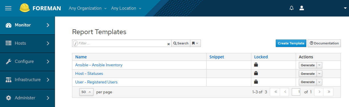

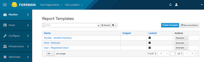

@jeremylenz Under Monitor > Reports > Report Templates, I see a list of report templates with a “Generate” button for each, but I don’t see “Job - Invocation Report”:
@jeremylenz I’ve already tried to create a custom template here but it doesn’t allow me to use anything other than puppet facts to build the report.
Is this perhaps a permissions issue? Unless you’ve deleted them, there should be dozens of default reports available. If you have access to log in as an admin user, does that help?

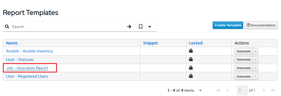

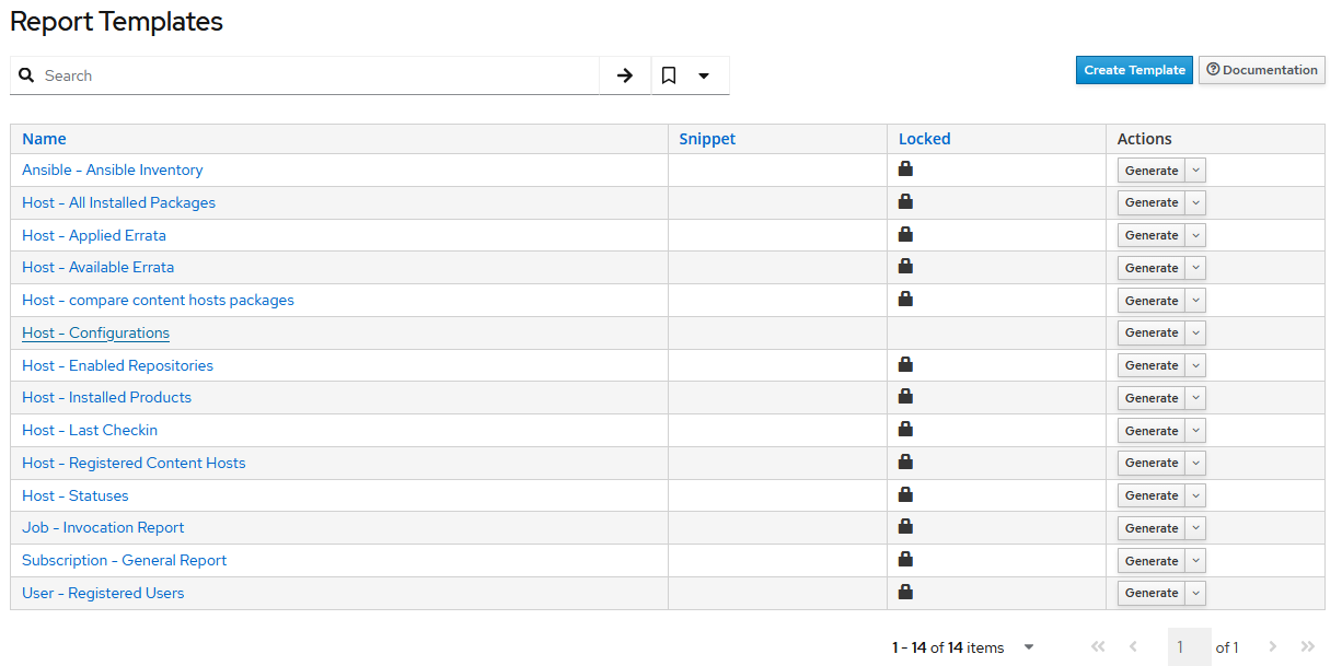

So the screenshots I shared in my previous post was on a “legacy” Foreman 3.13 that I didn’t configure and don’t know what went on there. However we also have a completely different instance of Foreman 3.17 where I do see the “Job - Invocatocation Report” template:
N.B: The screenshot above is on a “standalone” Foreman without Katello, but on another instance using Katello as well we do have more templates there:
Ah, gotcha. The available reports will indeed be dictated by which Foreman plugins you have installed. The job invocation report is provided by the foreman_remote_execution plugin.
Yes, the foreman_remote_execution plugin version seems very old on the legacy Foreman, that could explain why the “Job - Invocation Report” template is missing there:
