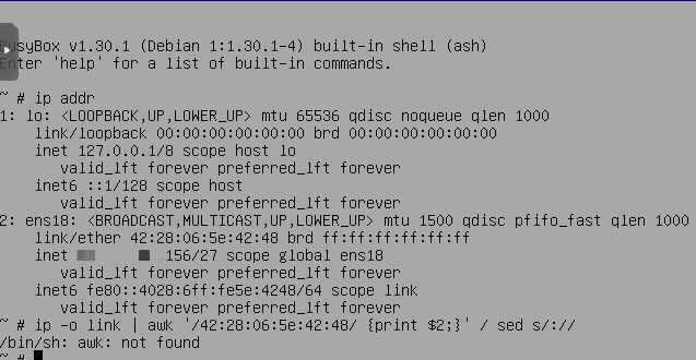

I managed to enter a shell and mentioned two things:
The interface’s name is ens18 and that command is really difficult to type on noVNC with a German-layouted keyboard and an English-layouted input :smiley:
Bildschirmfoto 2021-04-13 um 15.26.31
This is the result for my current attempt.

But from what I understand, isn’t the problem more in fact that awk is missing for some reason rather than from interface name? Because that is exactly for the shell line you refer to is - to actually ignore interfafe name and find the real identifier via MAC addres.
Hi @lzap
Alright, seems like I was able to solve the first problem:
Replacing
real=`ip -o link | awk '/<%= @host.mac -%>/ {print $2;}' | sed s/://`
with
real=`ip -o link | grep -i '<%= @host.mac -%>' | cut -d' ' -f2 | sed s/://`
returns the correct interface name now and /etc/network/interfaces looks fine now. The problem regarding the interface-name remains, but I’ll open a new topic for that.
