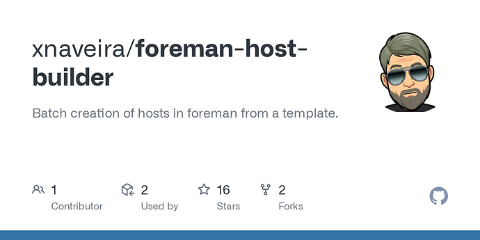

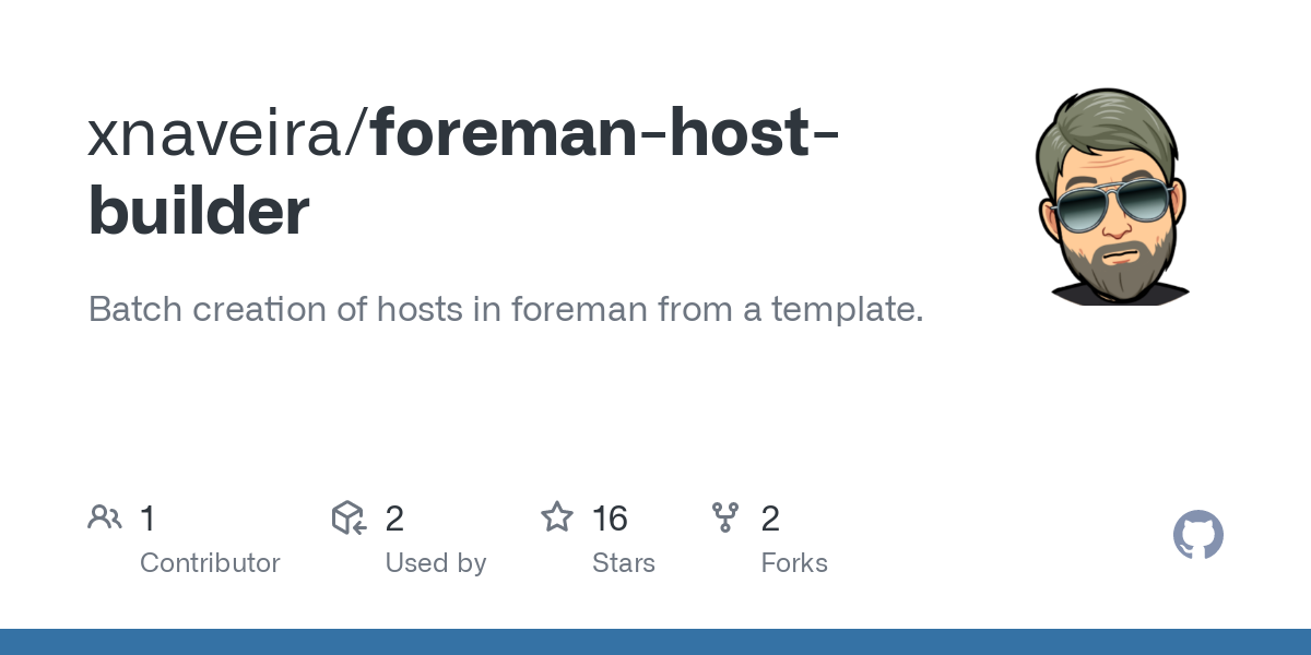

Hi Dave,
If you're ok with using python you might want to take a look to the
foreman-host-builder script that we're using on top of the python-foreman
wrapper:
Cheers,
Xavier
