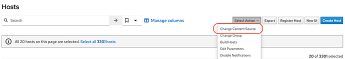

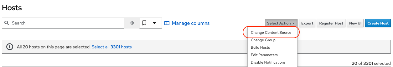

Updating host content source requires two steps - one on the server and one on the host. This is because sub-man configuration also needs to be updated on the host. (The hammer command would take care of only the server part.)
The easiest way to do it is thru the web UI, All Hosts > select your hosts > Change content source. That page will take you through it.
Since you are setting up a new smart proxy (as per your post above), you’ll have to run the script manually on each host. Or, you could do it a slightly roundabout way but could use the automatic REX job:
  1. change content source (via web UI, covering both server and hosts), to the Foreman server itself (this will ensure you can still REX to your hosts after the old smart proxy goes down)
  2. set up your new smart proxy
  3. change content source (via web UI, covering both server and hosts), to the new smart proxy load balancer url
