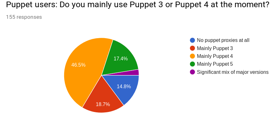

Starting the writeup of this years Community Survey data is actually on my list for today, but a quick preview for you:
If you throw in the 2.6% for “Significant mix” then we have over 20% of the community still making use of Puppet 3. This doesn’t surprise me - the upgrade to Puppet 4 is horrible, and enterprises are often slow to upgrade at the best of times.

@Gwmngilfen do you happen to have more exact numbers? I would especially be interested in a distribution of Puppet3 between <3.6, 3.6 and 3.8. My gut-feeling would be it’s safe to drop <3.8 today. But I might be wrong.
Sadly I do not, the survey only covered major versions. Tomorrow I can cut you a graph of change over the previous surveys, that may help.
My gut feeling is the same as you, however - I think people are on the latest major version in their OS, and are holding off on upgrading to 4.
