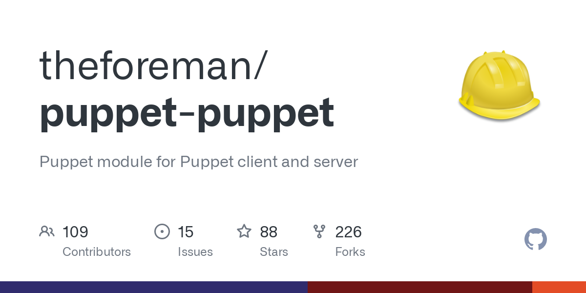

If your hosts are already using Puppet you could possibly automate it by
applying this module to change puppet.conf, and on the next run, when
reports are submitted, a new host would be created.
