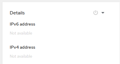

I am doing testing and validation of EL10 server builds and noted the following oddity with the server in Foreman.
Server registration worked as normal via subscription-manager register with and activation key. The issue is that the server information does not include the IP address of the server (static IP address). Anyone else encounter this problem yet and determined a cause?

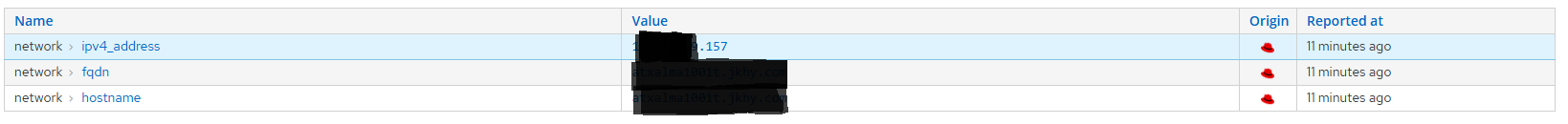

Review of the facts associated with this server shows the IP address reported via RHSM.
