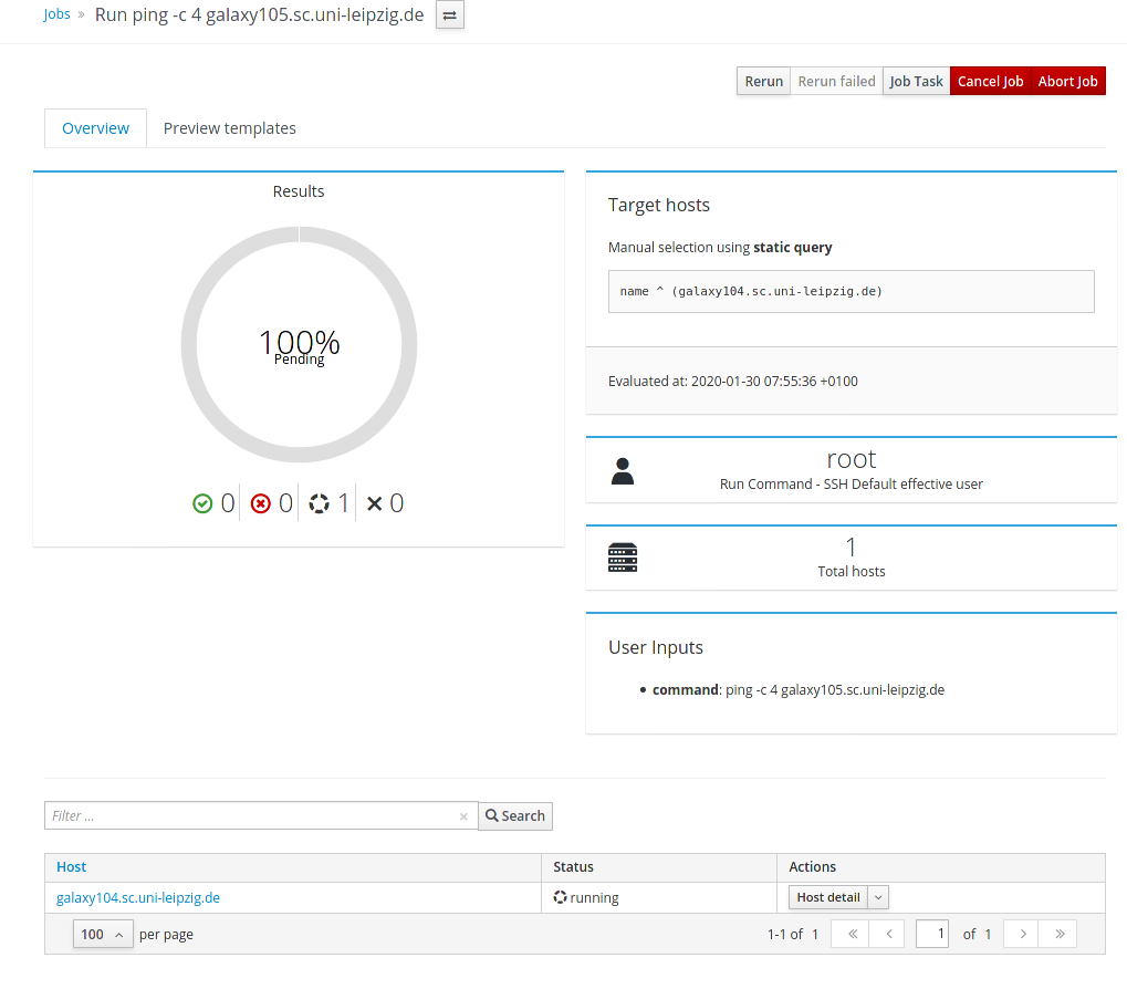

I’m iterating my Foreman installation since 2016 and i tried a few times to use remote exec and Ansible but haven’t been able. The websocket is running with official ssl certificates and somehow i get now feedback from the remote exec task which is definitely running on the remote machine.
No feedback of Remote Execution Task from remote host, UI doesn’t get feedback
Remote Execution Task ends successful and Foreman UI gets feedback changes status to successful ended
