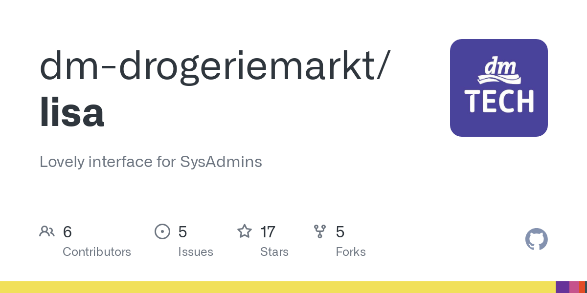

There is at least one consumer outside of Foreman itself:
I have heard a while back downstream of some consultants using it to make customized dashboards etc for customers. Would be worthwhile to ask SA/consultants and get a feel how much it’s being used downstream still.

We recently stopped using LISA and are discussing internally, what the best possible direction for the project should be.
I think we will archive the project and I will create a small community post in the Forum.
