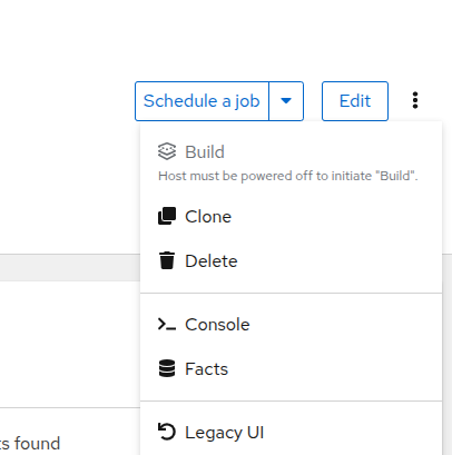

My proposal is, to disable the “Build” button on the Host Details page and add a description that the host needs to be turned off first to set the host in “Build” mode.
Just an impression, how it may look like:
This host is running (= powered on) and was provisioned with bootdisk.
Other thoughts?

API-first make sense. I added it to Fixes #39067 - rebuild only if host powered off by sbernhard ¡ Pull Request #10860 ¡ theforeman/foreman ¡ GitHub (including 2 tests)
