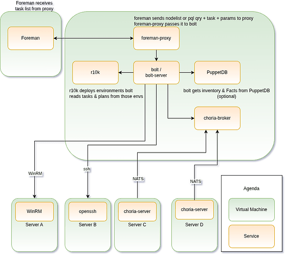

I came up with a very professional drawing:
I don’t understand all the pieces in the remote execution architecture yet, but my rough ideas:
  • There’s already support for remote execution via ssh, triggered from a system running foreman-proxy. I want to build upon this / extend it.
  • Foreman supports different job categories, ‘bolt tasks’ could be another one?
  • foreman asks foreman-smartproxy which talks to a local bolt-server to get a list of tasks + description, as an alternative to the current job templates.
  • After a user selected a task, they can enter the different parameters, data is send to the smartproxy and then to bolt-server
  • bolt reuses the ssh authentication credentials from the ssh backend
  • all targets, where a task was executed, return structured data, bolt-server itself returns a result set to foreman-proxy which in turn hands it over to foreman
Those are some rough ideas that I want to work out in the next time. If you’ve any ideas, feedback, concerns, let me know.

having seen your initial concept before you posted it, this would be a fantastic edition to foreman, and would be a big step (if not a nail in the coffin) for the desire for puppet enterprise.
I’ll be following this with great interest, and if there is anything I can do to offer help or support I’ll be happy to do so
I ike the idea of it being a foreman proxy capability pointing at bolt directly similar to other foreman-proxy functions.
One area I was initially unclear on and ‘wrong’ about was where bolt parameters would be stored, I expected them to be stored within foreman similar to smart class parameters, but I believe the initial concept is to keep them within the bolt task in the puppet module itself.

Would this be a part of the “triggering a job” flow or would this be a one-time action, similar to how foreman “imports” ansible roles?
I think it should be part of this in my opinion, because the tasks/plans can change on a regular basis. If this is a one-time thing, we need some kind of cache invalidation to update it from time to time. But maybe this also needs some performance testing.
What I would be worried about:
  • it might not fit well into how the ui currently works. You should be able to somehow bend it to your will, but there might be dragons
  • the whole behind-the-scenes machinery is tied heavily to job templates, which I’m not exactly sure what role they would play here
  • a single job can reach different hosts through different proxies
  • a proxy to be used for a given host is not known in advance
I’m not trying to deter you from it, just pointing out where I see potential problems so that you can prepare for them up front if you decide to go ahead with this.
Thanks for the great feedback,
initially I was thinking about a dedicated foreman/foreman-proxy addon for bolt support, that doesn’t rely/reuse the existing remote execution. I’m still unsure about the pros vs cons here.
Oh! Looks like I took a mental shortcut somewhere. Yeah, that could be an option too.
A quick update here. It’s currently unclear if Perforce will continue supporting bolt or if they will donate it to the community. If it will be donated, we will be able to provide patches for it (that also will be reviewed and merged). If that’s the case, we could provide some patches to enhance the bolt-server, so any foreman integration doesn’t need to rely on the bolt CLI, but could talk to the bolt-server API.
Good afternoon!
This project isn’t dead. I now know multiple companies running Puppet Enterprise, that want to switch to Foreman + OpenVox and are interested in a Bolt integration.
I did some deep diving into the architecture and made some changes. There isn’t a requirement for a puppetserver/openvox server, so I removed that piece. Also people have the desire to execute stuff without ssh as transport, so I added choria to the design. I hope that we can start development in the next few days.
