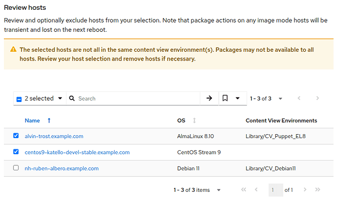

Of those options, I would go with a modified third bullet -
  • if you start a bulk action from X Host and you use Install Packages, it is checked whether the hosts have the same CV. if not equal → let users remove hosts so that you only have one CV left
I would be okay with a warning banner on the hosts select (review) step, saying something like
The selected hosts are not all in the same content view environment(s). Packages may not be available to all hosts. Review your host selection and remove hosts here if necessary.
The banner could be persistent on the host select (review) wizard step, as long as the condition persisted.
There could also be a reminder text added to the final Review wizard step.
We’d also probably have to add a ‘content view environments’ column to the host select (review) wizard step.

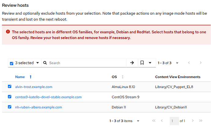

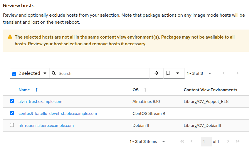

I have opened a draft PR that implements Jeremy’s proposal and goes a bit beyond. This is because Debian and EL hosts talk to different APIs what makes it difficult to have all packages combined on one page and this also seems not to make sense from a user’s perspective.
So we now have two warnings instead of one, one critical warning if there is an OS family mismatch and one if there is onlye a CVE mismatch. If there is an OS family mismatch, the package action cannot be performed (except the ‘Update all’ action).
OS family mismatch:
CVE mismatch:
