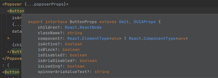

While this is theoretically useless for JavaScript projects, a good IDE will still use those for documentation. C.f. PatternFly Button:
