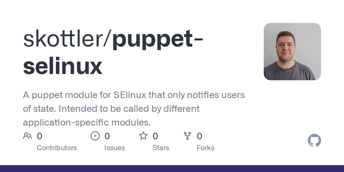

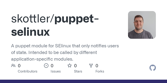

I've talked to a few people about this and the takeaway has basically always been "tell people the SElinux mode is wrong, but don't make changes" so…
It's a braindead-simple class that does exactly what I describe above.
