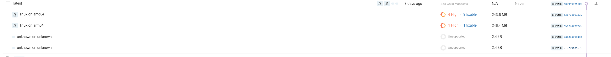

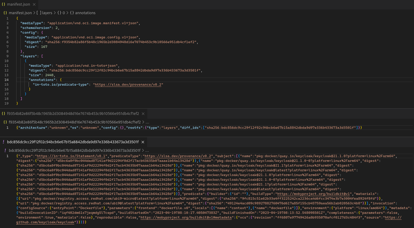

Out of curiosity I tried it myself now, and yep the same issue on Katello 4.8,
also was looking at the image meta for short, and I didn’t see the application/vnd.in-toto+json mediaType file up to now, wonder where it gets that from :thinking:
Oh! now I see it, Docker Hub doesn’t show it, but Quay does in the frontend! (the keycloak image)
It’s the 4th entry here
But with skopeo it’s also visible on Docker Hub:
  "mediaType": "application/vnd.oci.image.index.v1+json",
  "schemaVersion": 2,
  "manifests": [
      "mediaType": "application/vnd.oci.image.manifest.v1+json",
      "digest": "sha256:f3071e991039cb3b28c9bb449cf092b2c325433c7d01b21e3031c166c800408b",
      "size": 1056,
      "platform": {
        "architecture": "amd64",
        "os": "linux"
      "digest": "sha256:d5bc6a0f9bc044dad87141af9d22294f0d2f17acb43635b07aaae1b64a13428d",
      "size": 1056,
      "platform": {
        "architecture": "arm64",
        "os": "linux"
      "digest": "sha256:ea52aa9bc1c8df251cccc41b5c6f9fba91dc7d19f4b579f26d4c0348f6fda4ef",
      "size": 566,
      "annotations": {
        "vnd.docker.reference.digest": "sha256:f3071e991039cb3b28c9bb449cf092b2c325433c7d01b21e3031c166c800408b",
        "vnd.docker.reference.type": "attestation-manifest"
      "platform": {
        "architecture": "unknown",
        "os": "unknown"
      "digest": "sha256:210209fa5570513654521367a27972ba4dd0bcc00a6ee9066a4c037796096a15",
      "size": 566,
      "annotations": {
        "vnd.docker.reference.digest": "sha256:d5bc6a0f9bc044dad87141af9d22294f0d2f17acb43635b07aaae1b64a13428d",
      "platform": {
        "os": "unknown"
A little bit more tinkering with skopeo, the whole faulting thing looks like this:
So it’s just metadata from the build, and nothing else, would either need to be trusted/allowed in pulp or just thrown away.
And looks like this already got fixed in pulp_container last month, so it’s just a matter of the fix getting to Katello: Add support of in-toto mediaType · Issue #1227 · pulp/pulp_container · GitHub
