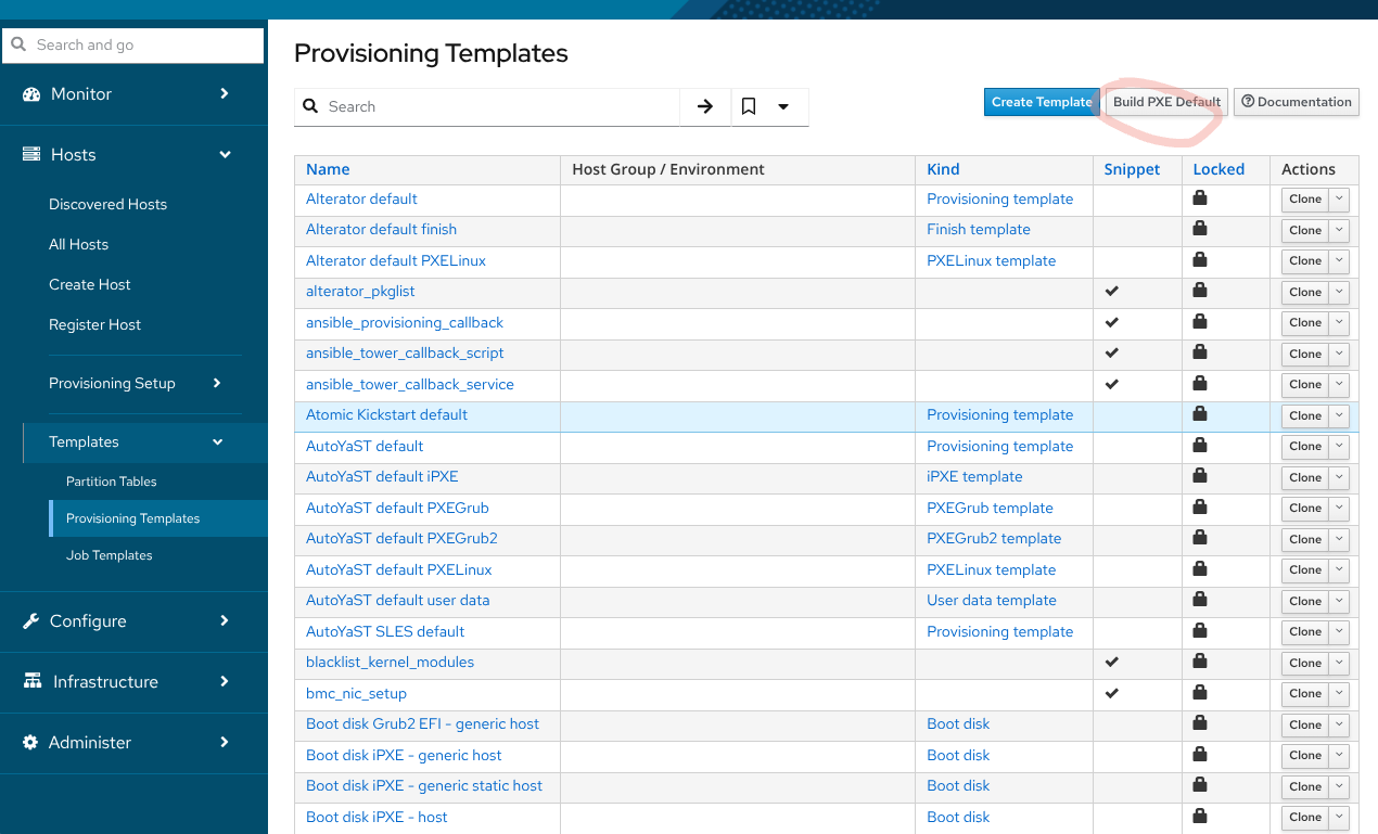

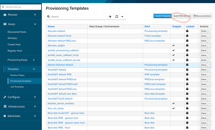

One other thing I just noticed, this message in the Grub client output:
Click on 'Build PXE Default' in the Foreman interface
to create the default global grub.cfg configuration.
However I can’t find this to click on in the Foreman interface.
I think you might be looking for this item:
Hosts / Templates / Provisioning Templates
Cheers,
Thanks, I have clicked that and it says the default is set.
