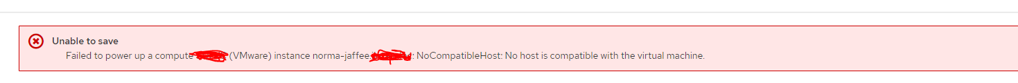

when I install windows server 2022 I am getting this error

What was the error from Vcenter? That error sounds like it was trying to access a resource in the cluster that is not available with what you picked? Do all the hosts support the hardware version of the VM you are using? Which VMware version are you using?
1 what was the error form the vcneter:
I am getting this error in the end its also delete the machine.
2: Yes, they support.
3. vSphere version 7.0.3.01900

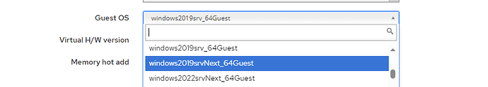

What is the different between winodws2022srvNext_64Guest and winodws2019srv_64Guest??
Can you adjust “Edit Default VM Compatibility” to “ESXi 7.0 U2 and later”. on the Datacenter or directly on the clusters. If you login in to the esxi hosts directly through the UI and try to make a VM, do you see server 2022 in the dropdown list of the Guest OS’s? I don’t know the difference off the top of my head but 2019 is the same Kernel as 2022 just like Windows 10 is similar to 11. So if you pick 2019 and try to install 2022 it should still work.
I found the problem I didn’t choose the right guest OS.
winodws2019srvNext_64Guest= server 2022
winodws2022srvNext_64Guest = server 2025

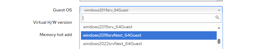

When i am trying to install winodws server 2022 I chose guest os winodws2019srv_64Guest equals to 2019 its works. (means the guest os will be 2019 but the server os is 2022).
If I chose winodws2019srvNext_64Guest I am getting this error
After you install Windows Server 2019, can you turn off the VM, edit the settings under VM options and change it to Windows Server 2022? That should fix the issue, so it matches the actual OS.
