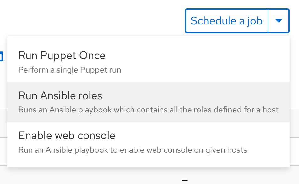

Hello, thanks for your answer. I would need the schedule remote action entry and also the “run ansible role” if it would be possible.
Those should both be available from the “Schedule a Job” dropdown:
You can click the Schedule a Job directly to schedule a REX job for future execution. Or you can click the dropdown to see the menu illustrated above.
