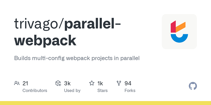

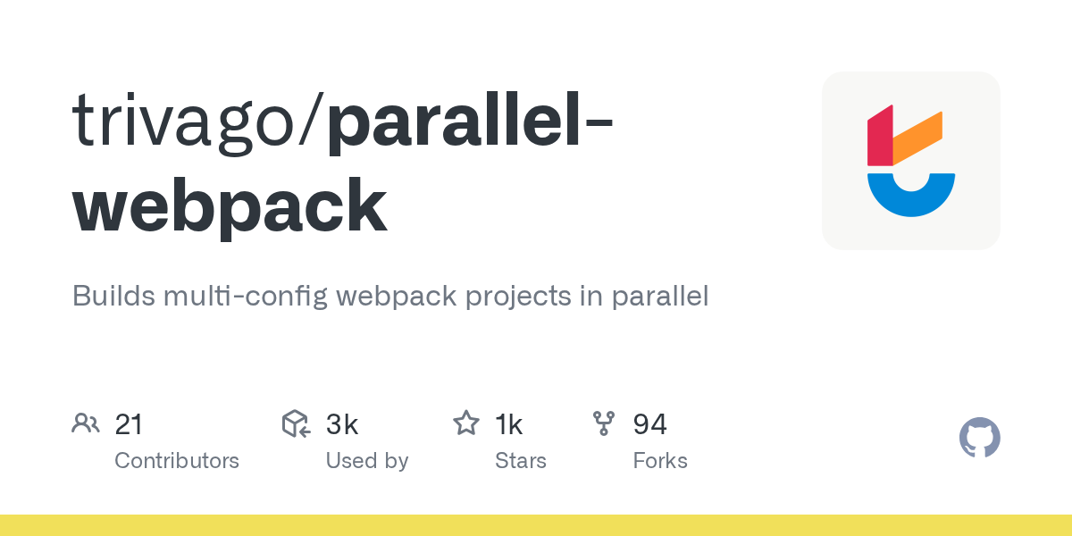

parallel-webpack
Using this library would allow us to build and run a development server with core, foremanReact, and plugins while they get to build in parallel.
It would allow us to watch and only build the parts that need to get rebuild.
