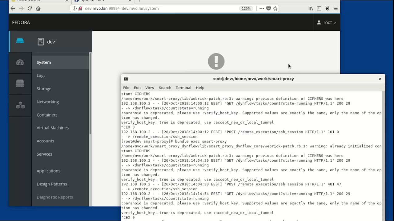

Here is a demo, with terrible sound (apologies):
The central piece for the Cockpit session is cockpit-auth-foreman
: https://github.com/mvollmer/foreman-cockpit/blob/master/cockpit-auth-foreman
It uses the new /api/v2/remote_execution/ssh_params
API of Foreman to get parameters like proxy, user, keyfile, password, etc, that are also used by REX.
It then uses the new /remote_execution/ssh_session
API in the Smart Proxy to start a interactive SSH session on the target host that runs cockpit-bridge
. Once running, it will pump the Cockpit protocol messages in both directions until the session ends. That API does a protocol upgrade on its connection, which is something new for Smart Proxy, I think.
