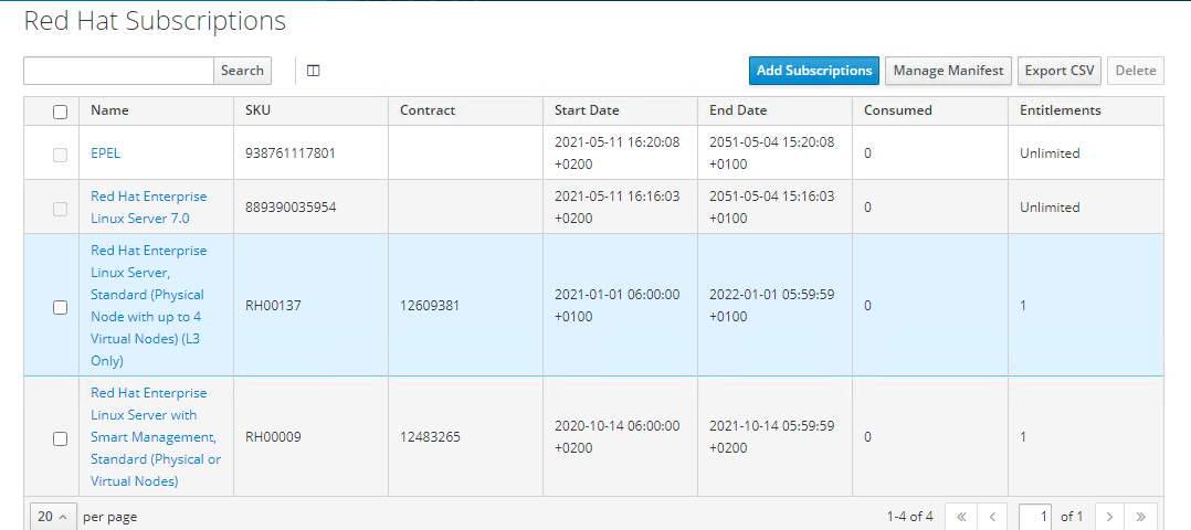

we have this subscription available
hello again i see not repsitory available on repository field see image

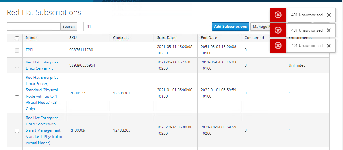

but something is giving 401 error as you can see in the image in the server log we see the same error
2021-06-28T09:27:30 [I|app|21448] Processing by Api::V2::TablePreferencesController#index as JSON
2021-06-28T09:27:30 [I|app|21448] Parameters: {“apiv”=>“v2”, “user_id”=>“4”}
2021-06-28T09:27:30 [I|app|21448] Current user set to admin (admin)
2021-06-28T09:27:30 [I|app|21448] Rendering api/v2/table_preferences/index.json.rabl within api/v2/layouts/index_layout
2021-06-28T09:27:30 [I|app|21448] Rendered api/v2/table_preferences/index.json.rabl within api/v2/layouts/index_layout (1.9ms)
2021-06-28T09:27:30 [I|app|21448] Completed 200 OK in 32ms (Views: 10.6ms | ActiveRecord: 12.1ms)
2021-06-28T09:27:30 [I|app|] Started GET “/katello/api/v2/subscriptions?organization_id=3” for 172.22.183.198 at 2021-06-28 09:27:30 +0200
2021-06-28T09:27:30 [I|app|8da38] Processing by Katello::Api::V2::SubscriptionsController#index as JSON
2021-06-28T09:27:30 [I|app|8da38] Parameters: {“organization_id”=>“3”, “api_version”=>“v2”}
2021-06-28T09:27:30 [I|app|8da38] Current user set to admin (admin)
2021-06-28T09:27:30 [I|app|8da38] Rendering /opt/theforeman/tfm/root/usr/share/gems/gems/katello-3.10.1.1/app/views/katello/api/v2/subscriptions/index.json.rabl within katello/api/v2/layouts/collection
2021-06-28T09:27:31 [I|app|50ea3] Completed 200 OK in 819ms (Views: 0.4ms | ActiveRecord: 728.6ms)
2021-06-28T09:27:31 [E|app|71b73] Unable to find upstream owner for consumer
2021-06-28T09:27:31 [E|app|71b73] exception when talking to a remote client: 401 Unauthorized RestClient::Unauthorized: 401 Unauthorized
Body: {“displayMessage”:“Invalid credentials.”,“requestUuid”:“48c0edb4-7b02-4291-93ec-e2d850a91375”}
/opt/theforeman/tfm/root/usr/share/gems/gems/rest-client-2.0.1/lib/restclient/abstract_response.rb:223:in exception_with_response' /opt/theforeman/tfm/root/usr/share/gems/gems/rest-client-2.0.1/lib/restclient/abstract_response.rb:103:in return!’
/opt/theforeman/tfm/root/usr/share/gems/gems/rest-client-2.0.1/lib/restclient/request.rb:809:in process_result' /opt/theforeman/tfm/root/usr/share/gems/gems/rest-client-2.0.1/lib/restclient/request.rb:725:in block in transmit’
/opt/rh/rh-ruby25/root/usr/share/ruby/net/http.rb:910:in start' /opt/theforeman/tfm/root/usr/share/gems/gems/rest-client-2.0.1/lib/restclient/request.rb:715:in transmit’
/opt/theforeman/tfm/root/usr/share/gems/gems/rest-client-2.0.1/lib/restclient/request.rb:145:in execute' /opt/theforeman/tfm/root/usr/share/gems/gems/rest-client-2.0.1/lib/restclient/request.rb:52:in execute’
/opt/theforeman/tfm/root/usr/share/gems/gems/rest-client-2.0.1/lib/restclient/resource.rb:51:in `get’

export manifest and import manifest
Could you try refresh manifest via Manage Manifest - Refresh.
yes i refresh manifest and now dont have error but in the next step how to create a product and content
Hello
i have already subscription without error
but in the Repository device I don’t have the option to add them
I only see ansible repositories in the list, not extra server or os
