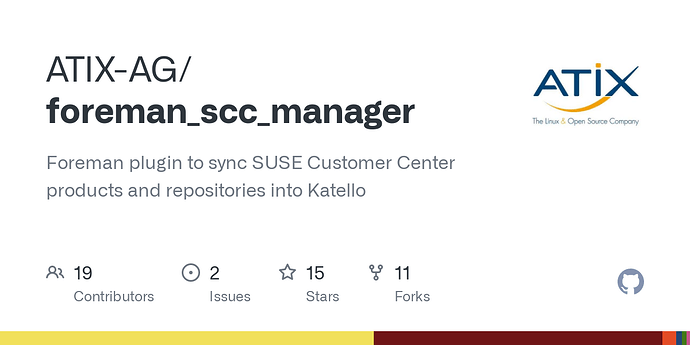

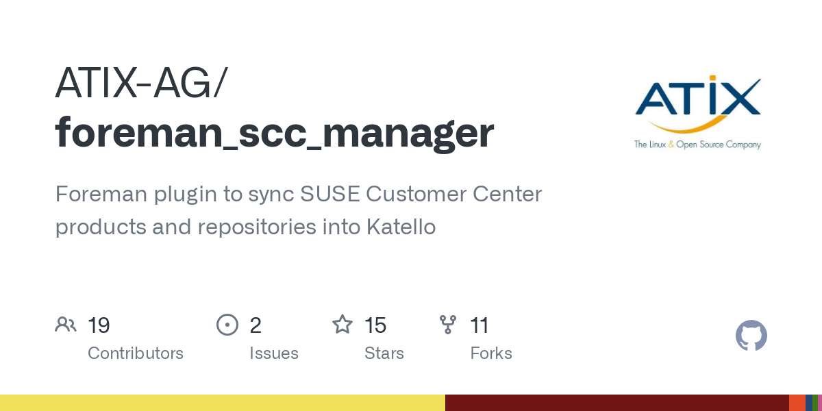

The reason why we have to stick with Katello 4.3 is because we need the Foreman SCC Plugin (SUSE) content. And according to the github repo GitHub - ATIX-AG/foreman_scc_manager at v1.8.18 it only works Katello up to 4.3. What is strange is that the github page refers to version 1.18.20 while the latest version that we see on our katello server is tfm-rubygem-foreman_scc_manager-1.8.17-1.fm3_1.el7.noarch. Is there a repo where i can grab the new version?

Regarding the SCC plugin: I am not sure why you are looking at the tree for 1.8.18, but with 4.3 there is really only a package for 1.8.17, with 4.4 and 4.5 a release of 1.8.20 exists. I used this plugin in different environments and different versions and it was never a show stopper on upgrades for me. The last bigger change was caused by the URL format changing because of the authentication which is probably hitting you here. This was discussed in SCC plugin issues after update to katello 4.3

According to the SCC Github Page:
For Katello 4.3 I should use 1.8.20
Compatibility
Foreman Version Katello Version Plugin Version
3.1 4.3 ~> 1.8.20*
I found the package in the nightly repo:
https://yum.theforeman.org/katello/nightly/katello/el7/x86_64/tfm-rubygem-foreman_scc_manager-1.8.20-1.fm3_4.el7.noarch.rpm
On my fresh Katello 4.2 install the upgraded package (1.8.20) solved the problem of:
