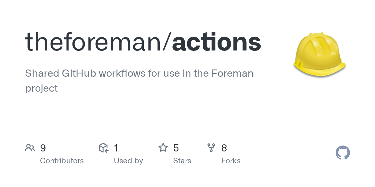

Since last week we now have CI on our CI: add a workflow to test our shared workflow · theforeman/actions@7d80eeb · GitHub tests the action when it’s changed.
There is also a reusable action to test Javascript, rather than just Ruby: GitHub - theforeman/actions: Shared GitHub workflows for use in the Foreman project
This is separate because you can trigger this only when certain paths have been changed (which isn’t documented, but standard GitHub Actions).
